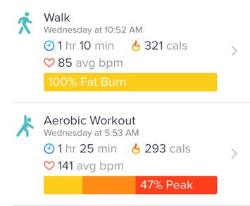

from my Exercises log
According to my new Charge 3, I burned more calories in less time by walking on the treadmill desk at work than I did at my class at the gym. I haven’t been able to get (what I consider) realistic calorie counts for my workouts since I switched from my charge 2 to my charge 3. It seems to be tracking my heart rate correctly. Is anyone else struggling with this?

Hey there @EllieSchuh, it's nice to see you around here! Thanks for taking the time to share your experience with Charge 2 and Charge 3. Thanks for the screenshot provided!
The algorithms used in both devices are the same, so you should see no more than a standard 4% variation between the two. It's possible to get different readings if the trackers are worn in different locations (dominant vs non-dominant wrist). We recommend reviewing the accuracy information provided on our help site at help.fitbit.com.

Hi Maria,
I guess my point is that I don't see how its possible that I burned fewer calories when I exercised for 1 hour 25 minutes with an average heart rate of 141bpm (47% in peak) than I burned when I walked for 1 hour 10 minutes (a shorter amount of time) with an average heart rate of 85bpm (lower heart rate, never exceeding fat burn). I was wearing the same fitbit charge 3 on the same hand on the same day.
Understanding how basal metabolic rate (or BMR) is calculated does not explain this.
Is this a glitch in the app or is my fitbit defective?
