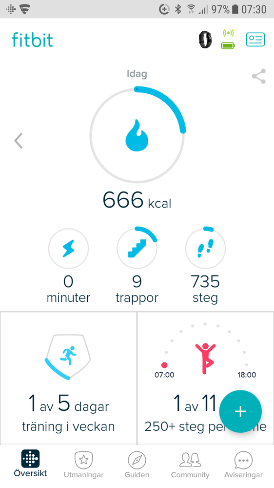

I do not think that you realize how bad it is. Let me give you an example from last week.
Before I started my bike ride to work I had:
Stairs: 9
Steps: 735
(I am not sure if the stairs were counted during sleep or during breakfast, though I know that they were counted before I saw any stairs.)

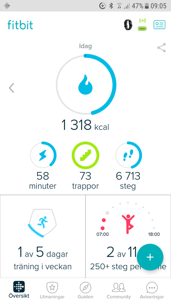

Arriving to work I had:
Stairs: 73
Steps: 6713
Which gives:
Real stairs: 9
Real steps: 735
Fake stairs: 64
Fake steps: 5 978

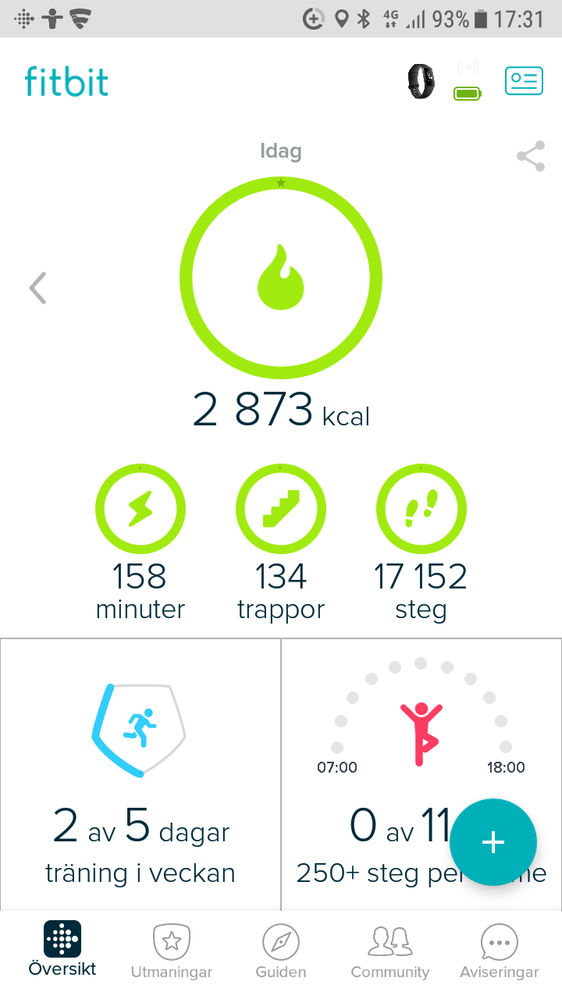

During the day I participated in a dance class which gave lots of real steps. Before leaving work the counting was:
Stairs: 134
Steps: 17 152
Translated ->
Real stairs: 70
Real steps: 11174
Fake stairs: 64
Fake steps: 5 978
When I left work I took a detour with my bike to get some exercise, when arriving home the counting was;
Stairs: 277
Steps: 31 540
Translated ->
Real stairs: 70
Real steps: 11174
Fake stairs: 207
Fake steps: 20 366
Looking at the data is it the real steps and stairs that are negligible instead of the fake stairs and steps. What goals can I set when the majority of the data is fake? What point is it to receive badges when it is mostly based on fake data?

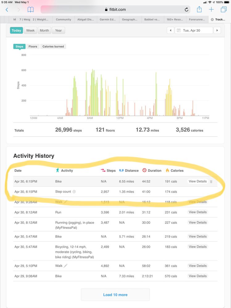

Best Answer04-30-2019 13:22 - edited 04-30-2019 13:22
to update my previous post, i can no longer see how many steps were counted during a cycling activity. until recently i could see that when i looked at activity detail in a browser. i can no longer tell how many cycling steps contributed to my daily total.
i think of this as a reporting issue, not a recording issue.

@buckowens wrote:to update my previous post, i can no longer see how many steps were counted during a cycling activity. until recently i could see that when i looked at activity detail in a browser. i can no longer tell how many cycling steps contributed to my daily total.
@buckowens — if you want to figure out the step count for your bike ride that is still possible. Just create a manual activity for the same time period (call it something like ‘step count’; see attached example I did for yesterday’s bike commute home). You can keep the manual record or delete it after you figure out the step count; it does not affect your daily stats, just provides detail about the time period you are interested in.
Scott | Baltimore MD
