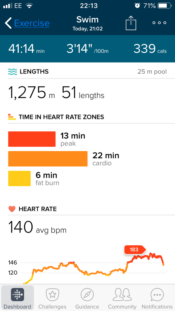

Hallelujah!!! the replacement Charge 3 has worked. Left the strap loose as advised, going to try it in normal tightness next time. Only 1 lap out but did leave it on while showering. 4830C122-469B-4E58-BE53-C92706BFC09F.png
 Now love it again ❤️
