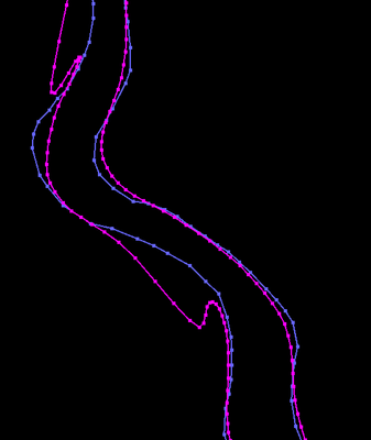

You might also find that if you zoom into the fitbit track that there's weird loops.
In this image the blue track is recorded in strava app, and the pink is fitbit. Same time, same run, same device.
Those weird backtracks in the fitbit trace seem to account for some of the distance discrepancies.
