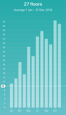

It seems to get worse over time. I set the goal to 10, which is a normal figure for the few stairs I climb. An average of 40 is way off...
