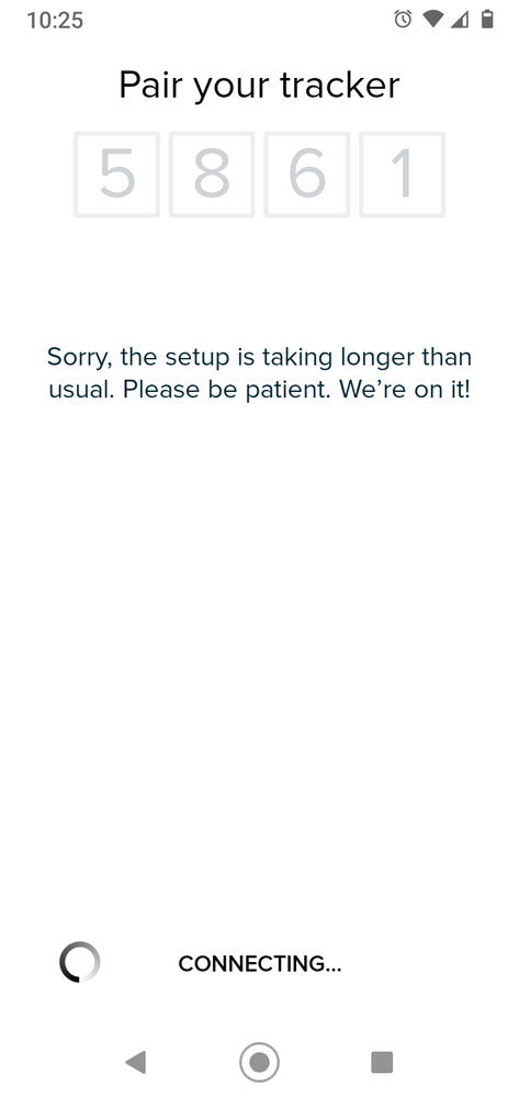

Alvaro, I am having the same problem with my Charge 3 and Moto g(7) power.  Can't get beyond the following page:
I have tried everything, and in the past have been able to overcome all pairing issues.  Before I waste more time on this, is there any way to determine whether the bluetooth function of the tracker is broken?  My tracker still seems to work in terms of counting steps, sounding alarms, etc.  Thanks for any help you can give.
