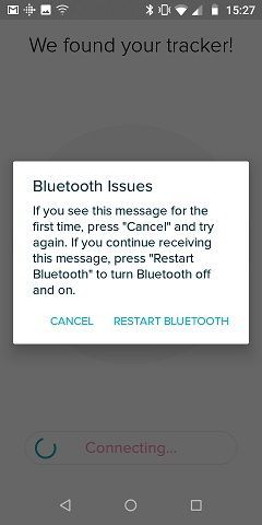

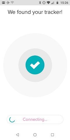

I cannot seem to get my Charge 3 to Sync at all.
Phone: Moto E5 Play
Android Version: 8.1.0
Android Security Patch Level: 1st January 2019
Build Number OCPS28 54-53-2
Fitbit Version: 2.87 (20213363)
Charge 3 Firmware: 28.20001.60.39
I have removed the Device and uninstalled the app, then re-installed the App and tried to add the Charge 3. However when in the App and try to set it up it says:-
however before it completes it then says:-
At the moment I have to sync through my NVIDIA Shield K1.
If I set it up through the NVIDIA, then I just get the Bluetooth issue message each time it tries to sync.

hi @Rich_Laue
I think you miss understood my comments.
First off I received my new Fitbit Charge 3 (Previously I had a Charge HR)
I deleted the Charge HR from My account using my phone.
I then tried to add the Charge 3 using my phone to my account. (At this point there where no devices on my account)
This produced the errors described above i.e. "We found your Tracker" then "Bluetooth Issue"
At which point no device was on my account.
I tried to restart the Bluetooth and I tried restarting my whole phone, but nothing would let me add the device using my phone.
I then used my tablet (Nvidia Shield) to add the new Charge 3 to my account. This went through without any issues at all.
At this point the Charge 3 was on my account and would sync via my tablet.
I then turned off the Bluetooth on by tablet and tried to use my Phone.
In Bluetooth it sees the Charge 3.
When I start the FitBit App (Charge 3 on my account, but not yet used on my phone) it display a message "Tracker not found"
Then on my phone if I go to Account - Charge 3 -
The Sync Now has an "!" mark in red.
If I try to manually sync on my phone I get the "Bluetooth Issue" screen.
If I turn off Bluetooth on my Phone and switch Bluetooth on on my tablet, I am able to sync my Charge 3 on my tablet.
I then turn off Bluetooth on my Table and turn back on Bluetooth on my phone, I then get the "Bluetooth Issue" in the Fitbit App on my Phone.
Therefore the Charge 3 does not sync with my Phone!
Hope this make sense
Thanks Alan

I followed all of your steps the one thing you did not mention was actually removing it from your device is Bluetooth. That's tough used to trip me up. It has to be removed from there, then remove the device from the Fitbit app and then restart your phone. From there it should be able to start from scratch.
Best Answer05-07-2019 08:41
05-07-2019 08:41
I had a charge HR and then went to the charge 3 just like you. I had to start everything from scratch and it worked fine for about a week. Now about every two weeks it will disconnect itself. I put it on the charger and let it charge. From there I go into my phone's Bluetooth and forget it from the device settings. From there I go into the Fitbit app itself and remove the device there as well. Then reboot your phone and start the whole process through the Fitbit app from scratch. That is the only way I've been able to get this to work.
Best Answer05-07-2019 09:02
05-07-2019 09:02
Hi @Ewall1976
You are a genius.
Deleting the Bluetooth device, deleting the device in App and re-adding, like you said, worked a treat.
Lets hope FitBit can work on a permanent solution. I'll wait and see if it un-pairs after a charge!
Alan

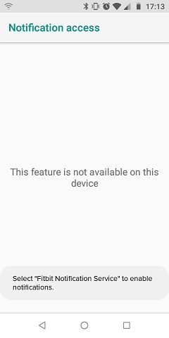

Hi
Now I have my Charge 3 on my phone it is no longer showing the "FitBit Notification Service" running on my phone. When I go into Device/Notifications it says "Enable Notification Service" but when I click on it it comes back with:-
The MOTO E is a supported device!
Has anyone manage to get Notification working? It doesn't even work for a Phone call, when my Charge HR did?
Thanks Alan

So I have had the very same thing. Text messages work for a while, notifications work for a while and then they stopped. One time I uninstalled the app following all the steps I told you before removing everything so it was a clean start. I think it is a little bit Fitbit and a little bit Moto. Realistically starting from scratch seems to fix a lot. Meaning uninstalling the app and everything from Bluetooth and then restarting the phone. But, if you want to try steps prior to that one, of the things you can do is remove everything like I had said before. Then while your phone is on the charger push and hold the touch button on the side of the charge 3 and wait for it to do its 7 pulses and then a :-), maybe it's a pulse is I'm not sure. Try this before uninstalling everything. that has cleared it up for me before but in the end it's just a gamble on which one works. I hate to say that all of these steps that rich tries to tell us about might work with other devices but I have never had any luck. Which is why I have followed what has worked for me. It is an annoyance and hopefully will be fixed.
Best Answer05-08-2019 15:19
05-08-2019 15:19
Sorry if my post come out a little janky. it seems trying to go back in and edit this page through my phone through Gmail edits does not seem to work well. Hopefully you get the point where doing the soft reset on your charge 3 and doing the other steps and starting from scratch may also help with the notifications. It starts to get pretty upsetting when the seems to be a common trend and there are a lot of people on this forum with the same issue. I know the mods try and help, but when it comes down to it Using basic software and hardware knowledge of starting over from scratch tends to be what works the best. At least you can predict your time around it.
Best Answer05-10-2019 06:38
05-10-2019 06:38
Hi @Ewall1976
I have tried this and it seems very temperamental.
When I first did it, it would show the service running and would receive calls. However when I went into the Charge 3 device in the app and sync for the first time it would first ask "Link FitBit with Charge 3"
When I clicked on OK the service would disappear and I would no longer receive notifications.
However saying all this, after playing and trying different approaches, I have it working for Phone calls, so I will leave the settings as they are for now. It does not appear to work for SMS or Calendar!
