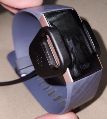

I am having the same issues as the original author, And I tried your suggestion above about holding it for the fifteen seconds et cetera, As well as the article you mentioned in a previous reply... Nothing helped and it's still black.
Background, we purchased it mid-late 2022, if not the begining of 2023 (I was in a stroke memory fog, at the time, and remember getting it, but I no longer sense/remember time passing accurately). I haven't used it for about 6-8 months, at most, because of a terrible psoriasis flare-up that included both wrists.... After charging it it vibrate-pulses and the back/charging area flashes green, but the screen stays black...
So, I followed YOUR step-by-step instructions suggested above, to no avail & then I followed ALL of the suggestions in the article: I tested the connection between the Fitbit & charger, cleaned all charging surfaces, I tested the USB port, etc. But still nothing...
I then re-attempted your step-by-step suggestion (with notable differences between the 1st and 2nd attempts mentioned below): When I connected it to the charger, ensuring accurate connection & after about 0.5 to 1 second into holding the button, it vibrate-pulsed once...I continued holding & about 2 to 3 seconds later (after the 1st vibration-pulse) it vibrate-pulsed twice in a row. Then at around the 10 to (possibly) 11 second mark (total, since connecting) it started vibrate-pulsing repeatedly & continued until I stopped (holding/pressing the button). I let go/stopped holding/pushing the button at around 15 to 16.5 seconds... I disconnected it, waited about 4 to 5 seconds, reconnected it (making sure there was perfect alignment/accurate connection) and (again) after 0.5 to 1 second after secure connection it vibrate-pulsed once, but then nothing had changed...it's still black...
(Should mention that the only difference between the 1st attempt (then following all the article suggestions) and the 2nd attempt, is that the 1st attempt it had the same initial vibrate-pulse, but didn't vibrate-pulse again (repeatedly) until around 12 to 13 seconds, continuing until I stopped pressing/holding the button... (so no double vibrate-pulse, after the initial vibrate-pulse, and the continual vibrate-pulsing started a solid 3 to 3.5 (or even 4) seconds later (than during the second attempt)...
(I attached a pic, as my husband CLAIMS it's a Fitbit Charge 3, but doesn't know where he moved it's box (containing ALL original paper contents, etc.), & he's one of "those" who is "NEVER" wrong, so I'm honestly not 100% convinced, and still wonder if it MIGHT be a different model... Hopefully someone can confirm if I'm wrong about WHICH Fitbit this is (& therefore I'm using the wrong method)? Thank you!🙏)
