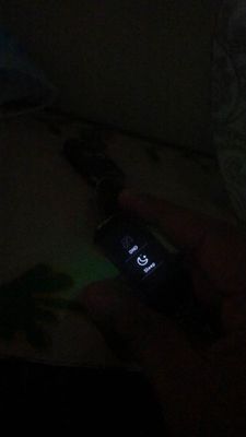

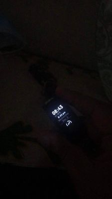

I am posting some photos here that shows what is happening, unfortunately I cannot upload a video. The fitbit transitions from main screen to the DND page and then back and again.
The fitbit charge 3 is acting up, even without any inputs.

@mskfit thank you for troubleshooting this issue and for providing pictures.
The engineers aren't in contact with Support nor would the reach out to you additionally there isn't a process to revert back to a previous firmware as mentioned before. Still I have created a ticket so our Support team can further assist you via email.
