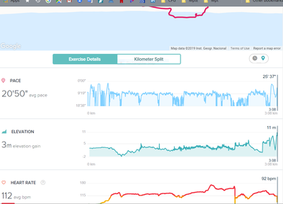

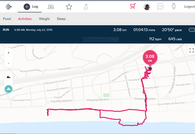

Everything still works.
The fitbit is still recording heart rate.
It simply does not display it on the dashboard where I need it.
the software still displays it on the dashboard for older workouts, so the software works.
