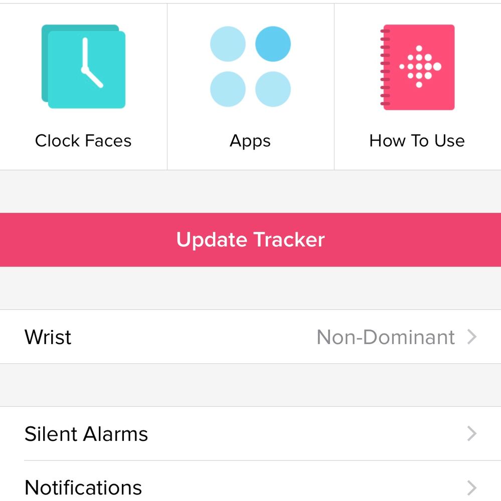

You need to connect the watch to the charger. Once charging hold down the side button for 8 sec until you see a smiling face. Then open your fit bit app. It should sync. Once it syncs then you need to hit the pink arrow that says Once it has completed the update the syncing issue should be fixed. Here is a pic of the update “pink arrow” 1788F433-06B0-4CCC-BDDB-C45FF02909F5.jpeg
 Then you click on the pink “update tracker”
