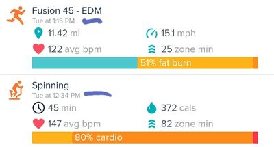

I am having the same issue! I have determined that fitbit is using the incorrect time, or that Echelon is sending it the wrong time. I tested this theory today and put my fitbit (versa 3) in exercise (spinning) mode while taking an echelon class. My workout was 12:30-1:15pm, and you can see the fitbit-originated "Spinning" activity tracked heartrate fine, but the Echelon synced activity "started" when my workout ended at 1:15! So the heartrate that the Echelon activity is using is my cool down time and beyond (measuring 1:15-2pm). This is really starting to drive me nuts and it would be really nice if it could be fixed!

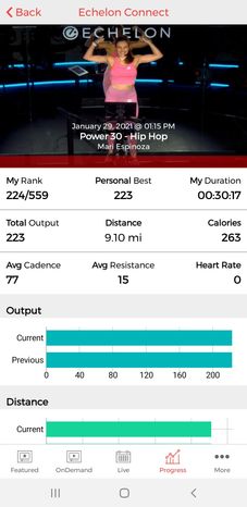

I have some additional info and screenshots.
I unlinked Fitbit from Echelon, relinked, and completed a ride today. Here is the screenshot from the Echelon Fit app, denoting the timeframe being 1:15-1:45pm.

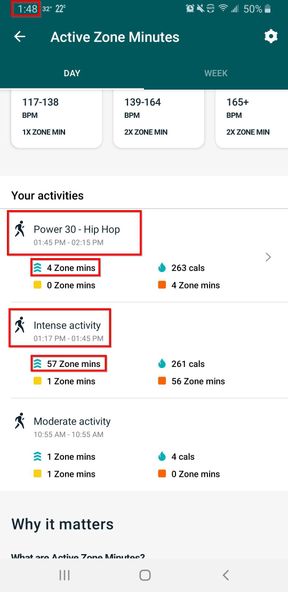

Here is what it looks like in the Fitbit app:
The Fitbit app shows a heartrate consistent with my intense activity 1:15-1:45pm. However, the actual ride is tracked incorrectly at 1:45-2:15pm! Additionally, notice that this screenshot is taken at 1:48pm, so presumably the workout was ended in the future, which doesn't make any sense.

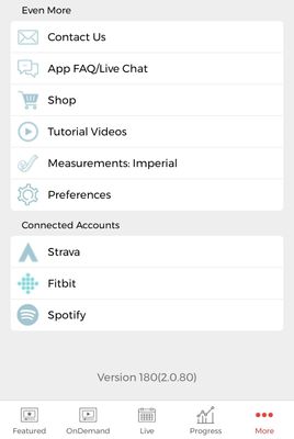

How did you connect your Charge 4 to your Echelon Connect? I am stumped???
Best Answer02-11-2021 17:39
02-11-2021 17:39
Here in settings in Echelon Fit!
02-11-2021 20:40
02-11-2021 20:40
Thank you!
