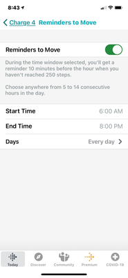

All was working well, but as of today my reminders to remove is gone on my CH4 device, When I go to my FITBIT app, my reminders to move will not stay on and will not show up on my CH4 device,
I have confirmed:
On your Charge 4
  • Turn off the Do Not Disturb (circle with a line icon) settings.
  • Turn off the Sleep Mode (moon icon) settings.
On the app:
  • Note that if you have set a sleep schedule, the reminders won't go through during that time.
Not sure why, but right after I sent the question above, my reminders was visible on my CH4 device, I have no clue what caused the glitch, but all is well again.
Moderator edit: merged reply
Hi @Blessingtoyou. I hope you're doing well.
Thanks for getting back with the requested information, as well for the screenshot of the Fitbit app. I'm glad that the reminders to move are visible and working well on your Charge 4. You did an awesome job! If there's anything else I can do for you, please let me know.
