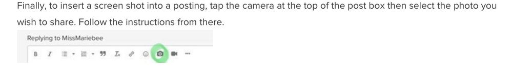

Finally, to insert a screen shot into a posting, tap the camera at the top of the post box then select the photo you wish to share. Follow the instructions from there.

Also, HOW did you post a pic?! Mine only let's me post if it's hosted, not able to UPLOAD anything and I don't want my private site hosting pix for Fitbit users.. such a weird business model going on here.
@MissMariebee - Did you see the instructions I posted below on how to inset a photo into your post?  Here they are, in case you missed it.
