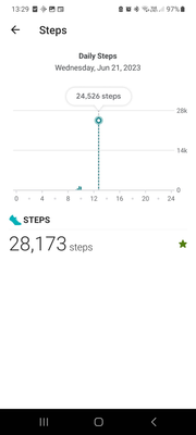

Somewhat bemused when before 9am this morning my Charge 4 starting buzzing for having reached 20,000 steps. On closer inspection the total was over 24,000 and when you look at the app this is all in big spike in the time line, which obviously doesn't make any sense whatsoever?!!! Unless I suddenly became the Flash and didn't realise it? 😂 Anyway to correct/remove? And any reassurance that it won't happen again...???

Happened to me today, was sat down working on pc till midday, stood up to stretch my legs at watch suddenly vibrates congratulating me on 20,000 steps. It had added over 24000 steps in one go.
Very odd!
