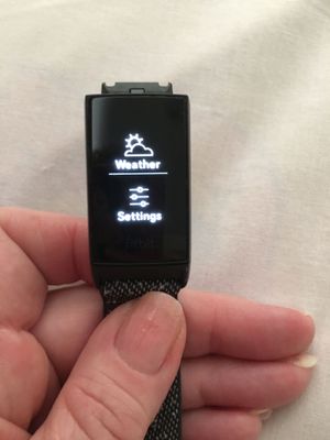

This happened to me and I just simply turned my phone off and then back on , otherwise  contact them direct
it’s on the actual watch not in the apps on your phone
on your watch swipe 4 to see settings
in
settings swipe up until you see gps settings
in gps settings
gps mode - built in gps
                 - glonass on
                 - gps low power mode off
i have attached photos for you and hope helps
Moderator edit: merged reply

GPS settings are on the Charge 4. When you swipe right to left you should get a first page that says Exercise and Spotify. Continue swiping right to left until you get to the end and there is Settings. Tap Settings and then swipe up. GPS Settings is second from last.

It's not that obvious, is it? It's on your Firbit itself, swipe right from
your clock screen to the fourth display that shows 'Weather' and
'Settings'. tap 'Settings', scrwl down 4 screens to 'GPS Settings and
you'll see the two optional GPS settings - GPS Mode and 'Glonass'.
