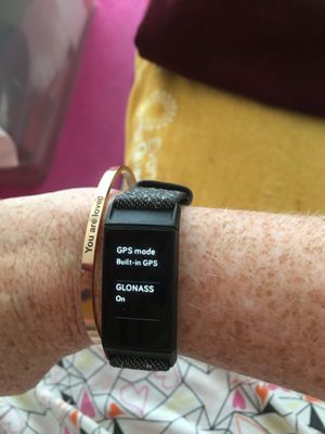

  screen shots of how to connect GPS when running , if you’re finding it drops out or just does not work
Good morning
I did post this once before but follow these steps and it should work
on your actual charge 4 you need to swipe to
settings
scroll up to GPS settings
GPS Mode - Built in GPS
Glonass - On
Hope that helps and i have included photos
Hi, I'm actually having a good run with mine. I got into settings,
selected inbuilt GPS, and 'Glonass' and it's worked. But it does stop
working from time to time. Usually at a crucial time. So I do a complete
restart on the fitbit band itself, and it's back to normal again. Hope it
works for you.

So what do we do when we have tried to troubleshoot this and none of those suggestions work?  I switched from an Inspire HR2 because the GPS wouldn't stay connected even with my phone with me during a run.  I chose the Charge 4 because I thought you were able to exercise without having to connect through your phone's GPS.  I have the most up to date version of the app, no trees where I am, weather is sunny and either I can't connect or it disconnects within 10 minutes.  This is really frustrating as everyone has already encountered in this thread.  Also, you have to start your exercise completely over to try to reconnect to GPS - which is ridiculous in my opinion - it does not allow you to try to reconnect while you are exercising or does not reconnect automatically.
Edited:  GPS settings = Built in GPS, GLONASS = On
