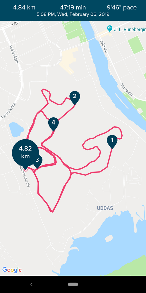

I set it to 'run' and had phone connected, and have perfect GPS track of my route on Fitbit activity's map. However, distance in Fitbit shows 4.8km while the real distance was 7.5km. Even pace shows about 10min/km which feels absurd compared to even casual jogging which is 6min/km.
How can it be so much off? How can it calculate distance on the map wrongly? Using Charge 3.
