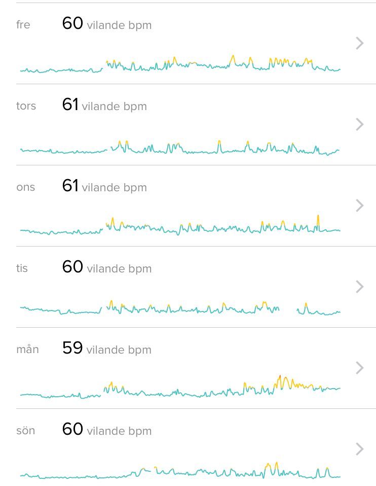

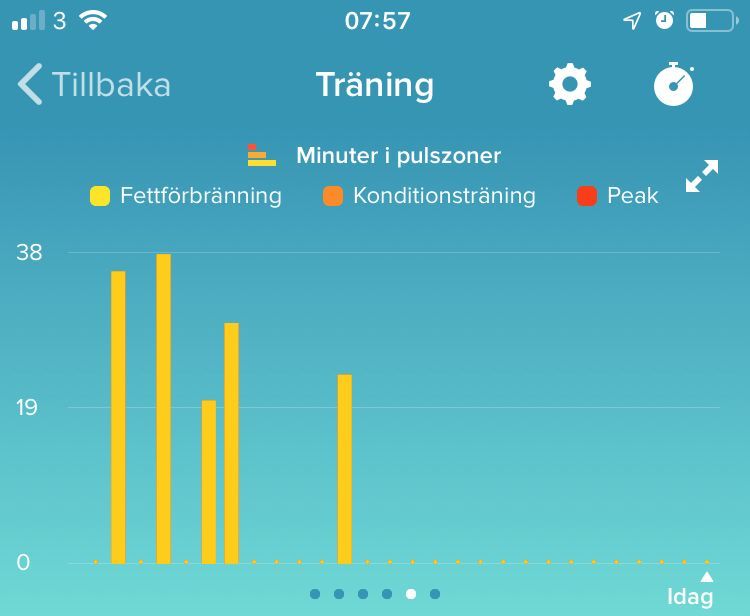

Before the update of the app I got 4-5 days a week with registered training, usually walks. I did not change my behaviour, but after february 4th I have no training at all registred. Today says 46 active minutes, but no training.

What is your definition of "registered training" Fitbit does not have any such exercise
Are you manually starting the walk with the Fitbit app or on the Charge 2. I would call this registering a walk.
If you let Fitbit decide what your doing, this would not be registering a walk but letting Fitbit detect the walk.

Sorry, my app is in Swedish, I guess it is exercise I mean. My heart rate curves look the same in February as they did in January, but nothing is to be found under exercise.

Ok that explains a lot.
Before you start a walk, do you press anything on the Charge 2 or the Fitbit app?

No I don’t but I didn’t before either
