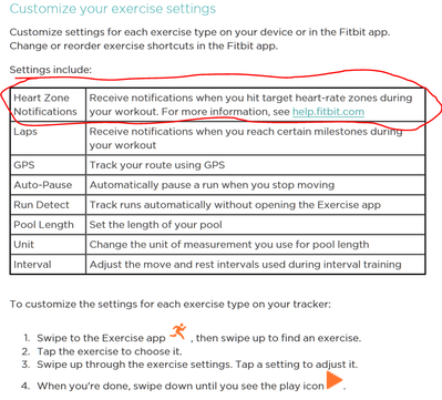

I think I know what those vibrations were.  There is setting, perhaps on by default, to vibrate every time you change heart rate zones, that care annoying if you are exercising at a point near boundary between zones.
There is a way to adjust settings in each exercise type within the Exercise App; I forget exactly on the Luxe but here's description from Luxe manual :
You probably want to turn that off for every exercise type you might choose..
