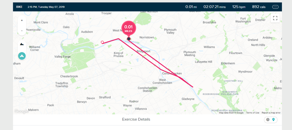

Using Charge 2 - I notice that my bicycling distance is not accurate most of the time. The time in accurate, but the distance is off as much as 50%.
Setup before I begin a ride: Open the app on my android (8.0). Start the "Bike" option on my Charge 2. When ride is complete I stop the "Bike" on my Charge 2. I look at the app and see the attached screen shot.
should be 24 miles
Observations: For example on April 24th, 2019. Fitbit indicated that I biked 15.96 miles, but I use this trail often and it is a 24 mile ride. The time was recorded correctly.
As you can see by the attached map screen shot, the ride was tracked correctly for part of the ride but then there is a straight line. (indicating a lost GPS signal?) It was a two way trip; meaning at the halfway point I doubled back using the exact same route.
So, the ride was recorded correctly for half the ride. I don't know if discrepancy was during the 1st half or the 2nd half of the ride.
Do you have any suggestions?
Will it matter if I have WiFi turned on or not? (I always leave it on)
Thanks.
05-08-2019 11:23
05-08-2019 11:23
@Reemo Welcome! It's nice to have you on board!
I will assist you with your GPS distance. As you mentioned it would be ideal if you turn off the wifi signal as this may interrupt the internet connection on your phone. There is also an issue with activities and the GPS distance so it is suggested that you try using the run option to help improve the distance calculation. Additionally you can check these suggestions to improve the GPS data.
Let me know how it goes.

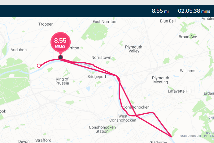

New Information:
I rode today and fitbit recorded the info in the screen shot below. Copied from my desktop computer:
It started out at the correct spot but apparently "lost" the GPS signal as I got close to the halfway point. It seems to have picked it up again at different points on the return. The distance of 8.55 mi is less than half of what it actually is.

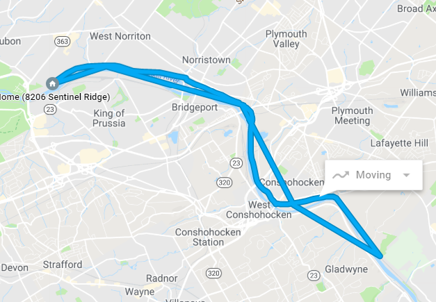

Just for a comparison; I looked at my "Google Timeline" for the ride today. The map is very similar.
Google had a more accurate record of the distance though. Google also mapped the finish back to where I started. Fit bit did not. I suspect this is due to the fact that Google uses GPS, mobile networks and WiFi for the location. As far as I know Fitbit is only using GPS. ( perhaps a moderator could verify this?)
My conclusion: I don't believe my Fitbit Charge 2 will record more accurately no matter which settings I change or how I use it. I believe if Fitbit can find a way to record maps and distances that same way Google does; then it would improve greatly. But it will not be perfect. I think the route I bicycle must have some "dead spots". Even Google lost the position for a while.
Perhaps Fitbit could modify it's system to use the "Google Timeline" that is already being recorded by Google?
