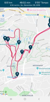

What a **ahem**te product the charge 3 is. Same track, look how far the 2km point is apart. Can I somehow refund this after 11 months?

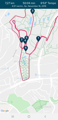

My 5km parkrun was 5.58km according to the Fitbit. The problem also affects how the device reports pace and distance as you run. I always begin recording from the Charge 3, and this way I get to see pace and distance and time. However because the fitbit reports that I'm travelling further than i actually am it gives me a faster pace than I'm actually doing. This leads to me mis-pacing the run.
eg it was telling me I was doing 4:50 to 5:00 mins/km pace, when in reality it was closer to 5:30min/km.

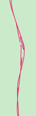

I get these loops backs reported as others have observed.
Also these brief gaps
