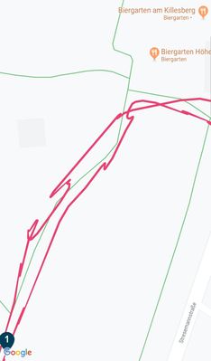

It is even getting worse and worse. Regretting a lot having bought the charge 3. Compared to fitbit disaster my phone with nike run app works perfectly fine.
Last run with fitbit: (no I was not drunk 😜 )
