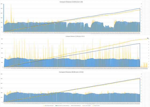

Did some further research and loaded the .tcx files into Excel to calculate the distance between the latitude/longitude points measured by FitBit manually, using formula:
Adding up the values between each trackpoint matches the distance calculation in GPS Track Editor exactly, which validates the distance calculation (based on FitBit data).
To compare the data in a graph, I plotted DistanceMeters straight from FitBit data, along with a calculated delta between each trackpoint - shown in blue. To compare against the GPS data added distance and delta - shown in yellow.
Image: https://ibb.co/DbHcwZj
For the activity on 22.04 (FitBit app version 3.18)
> similar result in distance calculation.
> some variation in the calculation for both FitBit distance and GPS distance (both lines are not exactly straight).
> FitBit trackpoints "follow" the GPS trackpoint trend, which is consistent with FitBit dynamically calculating stride length.
For the activity on 27.04 (FitBit app version 3.19.1)
> large difference in distance calculation.
> GPS delta distance between trackpoints very variable, GPS distance calculation shows jagged line.
> FitBit distance calculation shows a very straight line.
For the activity on 28.04 (FitBit app version 3.19.2)
> GPS distance calculation shows some variation.
Based on the above, there seems to be an issue with variability in trackpoints logged by FitBit with app version 3.19.1, but I don't see the same trend as @SgtPepper with app version 3.19.2...
In any case, this indicates FitBit uses stride length as the base for distance calculation, rather than the actual GPS data, which explains the differences in distance calculation. This is *not* what's indicated at https://help.fitbit.com/articles/en_US/Help_article/1141, and produces a less accurate result. Stride length should be used when GPS data is not available, instead of the primary measurement (even if that is automatically calculated).

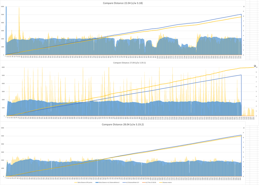

=ACOS(COS(RADIANS(90-Lat1)) *COS(RADIANS(90-Lat2)) +SIN(RADIANS(90-Lat1)) *SIN(RADIANS(90-Lat2)) *COS(RADIANS(Long1-Long2))) *6371
This indicates FitBit uses stride length as the base for distance calculation, rather than the actual GPS data, which explains the differences in distance calculation. This is *not* what's indicated at https://help.fitbit.com/articles/en_US/Help_article/1141. Stride length should (only) be used when GPS data is not available, instead of the primary measurement (even if its automatically calculated).

@Povilas I don't see the difference in the map screen for any of my runs.
I've had a bit of back-and-forth with FitBit support, but unfortunately no solution as of yet.
Another two days of data to add to the stats (@SgtPepper I noticed you've updated the stats as well) and I now also see a large (!) variation with the latest app version. In between the runs on 29.04 and 30.04 I have reinstalled the app and unpaired/paired my FitBit device, as suggested by support. However this didn't seem to have an effect (if anything, it seemed to have made things worse..
FitBit | GPS track editor | - local inconsistencies | ||||
Date | distance | distance | # of incons. | distance | FitBit <> GPS | FitBit <> GPS |
15.04 | 5.07 | 4.85 | 12 | 4.85 | -4.5 | -4.5 |
16.04 | 5.05 | 4.73 | 49 | 4.67 | -6.8 | -8.1 |
20.04 | 5.03 | 4.95 | 6 | 4.95 | -1.6 | -1.6 |
22.04 | 5.06 | 4.72 | 5 | 4.72 | -7.2 | -7.2 |
23.04 | 5.02 | 6.07 | 244 | 5.8 | 17.3 | 13.4 |
27.04 | 5.07 | 6 | 326 | 5.61 | 15.5 | 9.6 |
28.04 | 5.14 | 5 | 4 | 5 | -2.8 | -2.8 |
29.04 | 5.11 | 4.7 | 2 | 4.7 | -8.7 | -8.7 |
30.04 | 5.02 | 6.49 | 383 | 6 | 22.7 | 16.3 |
What's interesting is that usually FitBit reports a slightly larger distance than GPS Track Editor calculates, and there are only a few (2-49) inconsistencies in the GPS data. However in some cases (23.04, 27.04 and 30.04) FitBit reports a much lower distance than GPS Track Editor, and there are many (244-383) inconsistencies in the GPS data.
Not sure what causes this, but I'm trying to be as consistent as possible - doing the same run and starting the FitBit activity from the activity tab on the pebble itself. The difference with yesterday (29.04) is that at the point (=petrolstation) where yesterday's run finished, today (30.04) FitBit only recorded 4.10km, almost a km more to go!
