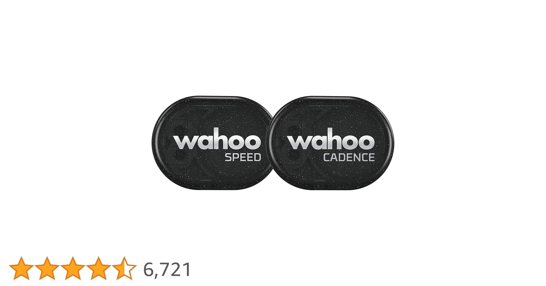

@Springy.BitFit it isn't possible to detect revolutions by wearing the wristwatch as it isn't so simple. The majority of sports watches require an external cadence and speed sensors attached to the bike. Something like this:
https://www.amazon.co.uk/Wahoo-Cadence-Sensor-Android-Computers/dp/B01E0YRQIA
You attach the cadence sensor near pedals (or even to your shoe) and the speed sensors on the wheel, then you pair the watch with those sensors to obtain data. A proper sports watch should be able to combine data coming from sensors and GPS to improve overall accuracy.
