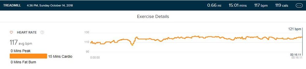

@Blackish and @MarreFitbit -
Another test last night with the device one inch higher on the arm.
One small dip for a short period of time into high fat burn (quite acceptable) and then "rock steady" in cardio and right on each time I compared it to a manual count.
I did say, I was a believer, it's this is the first time I've had to move a device to get back on track as far as the heart rate goes.
Not quite ready to mark as solved, but pretty close.
