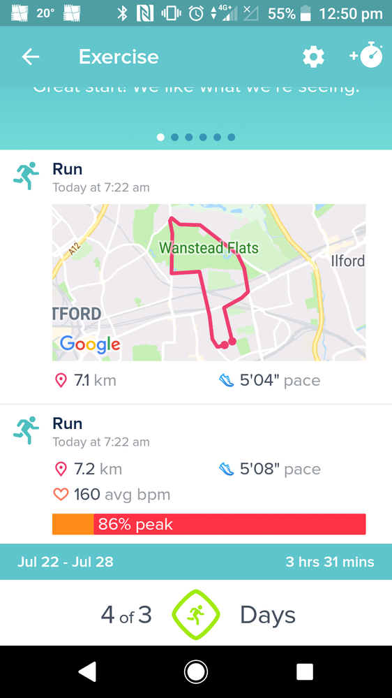

My Charge 3 does not log heart rate when I GPS track exercise during the session. If I manually log the same run after the event, then Fitbit shows the heart rate against this exercise but I lose the GPS tracking. Why is this?

HI Alejandra,
Yes my phone is definitely compatible and this is a recent change. Here is a screen shot of a recent GPS tracked run, minus heartrate and then after I'd manually entered it, without GPS, where fitbit has added my heartrate.
Let me know if you need any further screens hots.
Thanks
James
