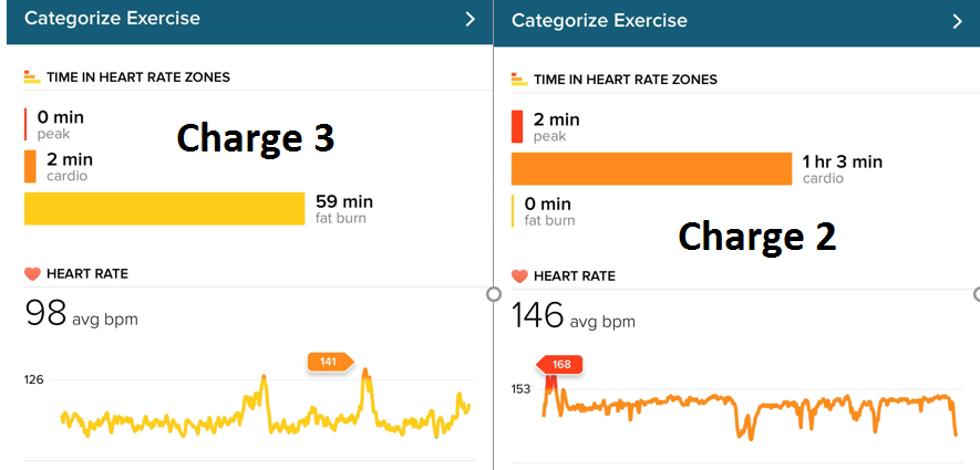

Charge 2 more consistent
Here is the issue I’m having. The charge 3 shot up initially and then kept me in the fat burning range around 107 for the duration, whereas the ol’ Reliable Charge 2 stayed consistent between both ranges during my workout. I was jogging in both examples. So I’m having a similar situation!!!

Look at how different mine is .....
