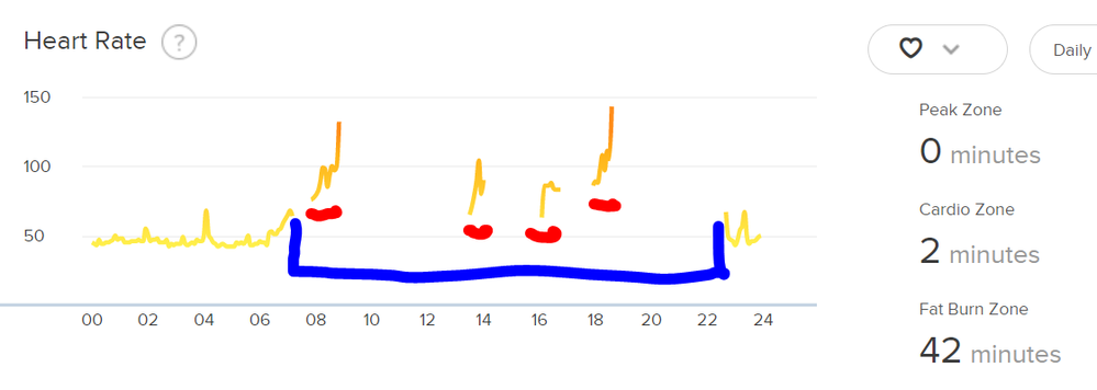

My Charge 4 does the same thing. I can't wear my device at work, so it sits in my gym bag in the car during the day. This is what I regularly see. Not much of a response from FitBit, except to reset the device, which does nothing.

My Charge-4 would do this when in my gym bag during the work day, since I can't wear my tracker at work. I can't say that this is a fix, but I have had better luck with my Charge 4 laying on it's side. Previously, I would lay it face down on top of my gym clothes. Now I curl the strap up a little and put it in my workout shoes, on it's side. See if that helps.
