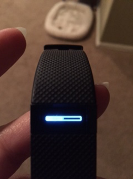

Love my Fitbit HR that I got for Xmas...but.  Worn every day since 12/26. Yes it's charged, updated, synche'd etc (currently v 102 which was an upgrade notice that I got after day 1 or so.).  Worked great for a few days but there have now been 5-6 times in last few days when it goes to half white bar, half black bar.  Yep, I've restarted via plugged into my computer.  I've even "fixed" it by holding down button for 10-20 seconds and just waiting (did this since I was away from computer).  I've even just pluggged in the wall USB charger.   It may be sensor related as I've noticed it flatlined when I was simply taking off wrist or adjusting on wrist.  I emailed support, but just wondering if anyone else experienced this.

Hey hey hey @iampeterd welcome to our Community! It's nice to have you on board! Smiley WinkI'd like to confirm this is exactly what you're seeing on your Charge HR:
If this is what you're seeing it means that the firmware on your tracker didn't updated as it should so I'd suggest you try to re-attempt the firmware update. Please try several times (8 - 10, apologize for inconvenience).

Hey thanks much.  Yes that is exactly what I saw - but after I updated.  It would run fine and then change to that half completed progress bar.  I would do restart, etc.  Everything would be fine for a couple of hours then it would just go back to that half completed progress bar. On phone with support they said they saw hundreds of error messages and that is why they would send me a new one.  Soon as I have some free time, I'm happy to try restart 8-10 times to try and resuscitate this one.

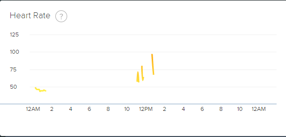

Just to give you an update @HeydyF - I tried the suggestions provided again, and here is my log for today.  When I say "restart" I am plugging it into USB, holding down the button for 10 seconds until the LEDs flash, removing from USB, and then pushing the side button.
  • Restart at 10:57a - Failed to "progress bar" at 11:10a
  • Restart (x3) at 11:19a - Synced at 11:25 - Failed to "progress bar" at 11:26a
  • Restart (x3) at 11:33a - Synced at 11:34 - Failed to "progress bar" at 11:44a
  • Restart (x5) at 12:41p - Synced at 12:42p - Failed to "progress bar" at 12:54p
I have been wearing the Fitbit Charge HR all day (but for the time I am charging / restarting it).  As you can see from HR graph, it records data for a few minutes, and then fails again.
I tried contacting support - was on hold for 15 minutes and hung up.  Went to the on-line chat and had a simliar experience - on hold for 15 minutes and then had to leave for a meeting.
Thoughts?
Update for @HeydyF - Factory Reset last night revealed error code 0x0009.  Failed to "progress bar" within 10 minutes.  Back on the charger overnight and worked for about 10 minutes this morning.    I just got off the phone with Fitbit Support (about 12 minutes total conversation time) and a new Charge HR is on the way.

Encountered this problem today,  stalled progress bar at half way point like the one in the photo.  Contacted customer support and spoke with Walter. A polite person but, pretty much a total waste of time tried multiple resets, deleting and re-establishing my account. None of these steps works all my Iphone says is that update not completed. I didnt initiate an up date and my computer dashboard shows that my update is current.  So now I am told I get to wait for an indefinite amount of time before someone "higher up" can contact me .   I do not know if this will be an hour, day , month, or year.  Not impressed in the least got this tracker for Christmas and it utterly failed in what 8 months.
My Charge HR failed to respond to button pushes yesterday although I last charged it 2 days earlier.  Connected it to my charger and only received the half bar you show.  Tried everything I could find on the Internet and finally contacted Customer Support.  Very nice person walked me through steps I had already completed and concluded it's terminal and is sending me a replacement.  Warranty is one year but my records show I purchased mine 13 months ago.  Hope the new one shows up okay.  Half bar display is a bad sign, especially when you become so accustomed to your Fitbit.
Welcome to the Fitbit Community @Pat23452@MHarryE, if you haven't already done so, as an alternative you can also try all these steps to resolve any possible issues with the firmware update process. I hope this helps.
