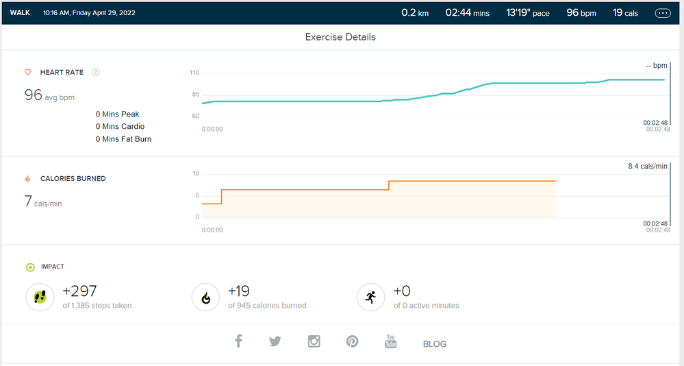

Just curious, can you share the screenshot of the KM shown on the app?
Best Answer04-29-2022 07:27
04-29-2022 07:27
Sorry didnt have much time the last couple weeks. Just now I changed the config on the fitbit to use the internal GPS instead and I walked down my laneway and back. It recorded my KM but I cant see the map anywhere.
