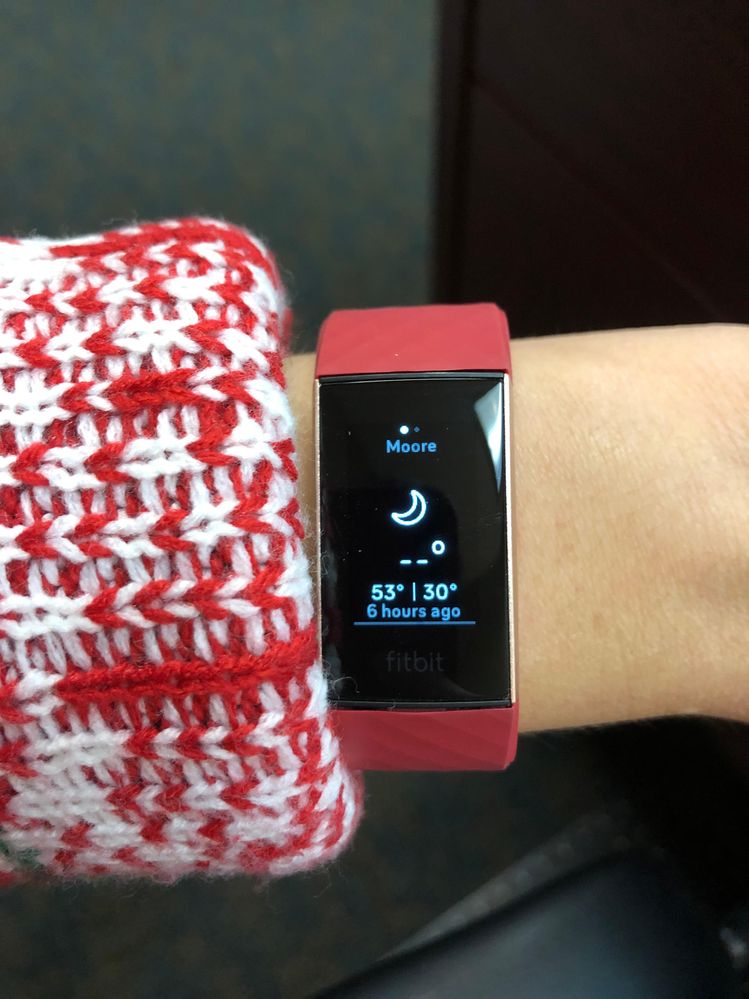

This is what I see also.  I work in a different town from my home.  So I have my home town and another town.  But I don't see the "local" weather (where I am at work).
I've already synced my Fitbit to the app several times today and it still says the last time temperature was taken was 6 hours ago.
My Versa doesn't have any weather issues, so I believe it's related to the Charge 3.
Heather | Community Council | Eastern Shore, AL
This is what mine looks like.  Moore is not my current location.  And like I said before, I've been syncing to the app multiple times today and this is what it's sitting at.

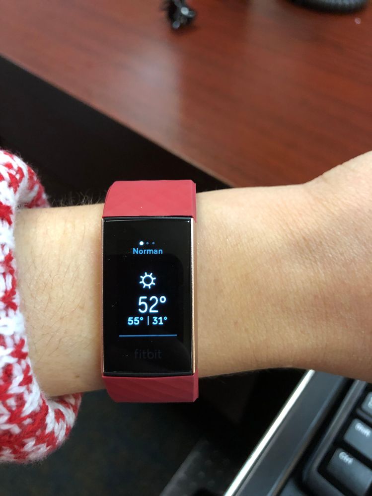

So I just went to the Fitbit app and opened up the Weather app inside Fitbit. And now it’s working.
But I feel like you shouldn't need to open up the weather app inside Fitbit to receive accurate weather.
