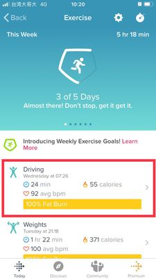

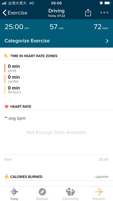

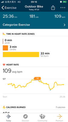

Hi @AlvaroFitbit ,
Thank you for your reply. I just tried the method you offered but it did not work. The logged activities always show nothing in the content. But the auto-detected outdoor bike activity (the motorcycle riding) did show the activity information. Is there another solution to deal with this?

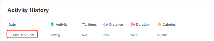

Hi @AlvaroFitbit ,
Here's some information regarding the driving log issue I just figured out.
The time of the manually logged activities in Fitbit app will be registered in Greenwich standard time on the server regardless of the time zone setting in the app. This should be the reason that the logged driving activity could not obtain proper information to negate the extra steps. Please pass this information to your engineering team and solve it at your earliest convenience.
The temporary solution for this is to log driving activities on the website and then they will get the correct information.
