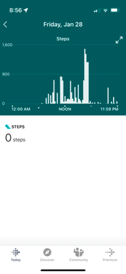

I'm a long-time Fitbit user but very frustrated with missing step records! There are four consecutive days (Jan 28-31, 2022) which show 0 steps for the day, yet on each of those days there are recorded exercise sessions that show steps. I can also see steps across each of those days when I look at them on the Fitbit site on my laptop. On the days affected I can definitely see total steps for the day on my Charge 4, but they are not completely registering on my account. It's happened before with one or two days, and when I've called customer service, they just tell me I have to be sure I sync every Sunday. I'd like to get my step records corrected and also avoid this in the future. Seems like some kind of a bug if the steps are actually visible but not totalling for the day. Has anyone else had and solved this issue?

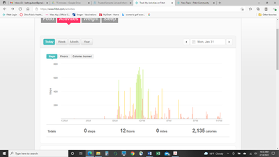

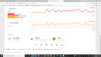

The steps have been recorded. Below are two screen shost from my activity log on Fitbit.com for Jan 31, 2022. You can see the steps are in there, and they were totalled for this exercise session. They are not really gone, they just aren't in there for purposes of a total step count for the day.

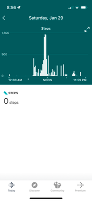

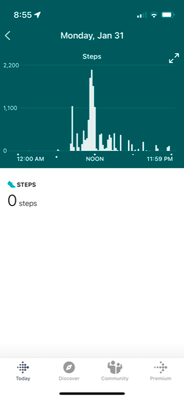

I tried to send screen shots from my phone in reply - didn't work. In answer to your questions, yes, I can see this in the app as well. Please see screen shots below.
I have not done any manual entries for these four days. I seem to recall when this happened before, a chat agent suggested that I delete the exercise session and enter it manually, which actually restored all the steps for the day. I may try that but wanted to fully document the situation and exhaust other options before doing so. This is probably the third time this has happened, and twice I used the help chat in the app to get it resolved, but it seems to keep happening so I wanted to try the community forum in case someone else has had this experience. It has not happened again since this four-day range of missing steps.
