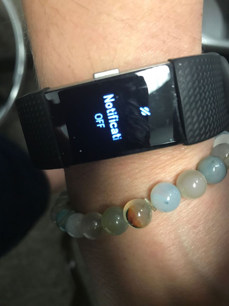

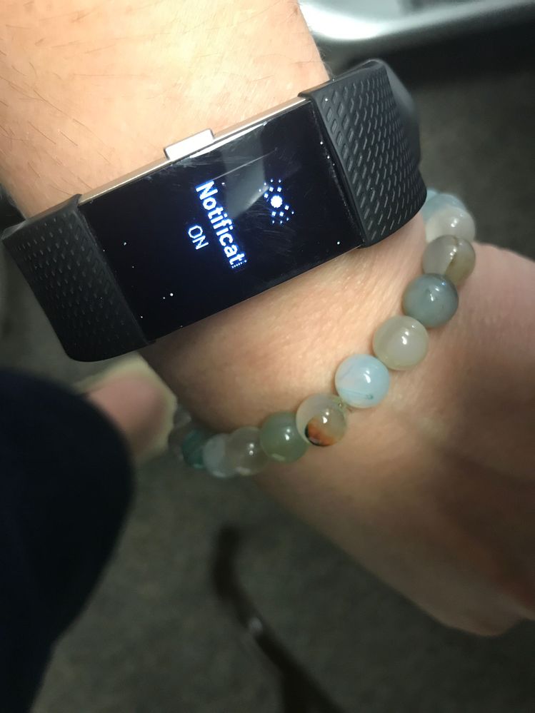

Make sure notifications on your Fitbit are turned on.To do so, simply press an hold the side button on your Fitbit. The graphics should appear stating “notifications on” or “notifications off” When connecting the Fitbit to its cradle charge it is very easy to accidentally turn it off.
Other things to be aware of...make sure your Bluetooth on your phone is turned on and/or you haven’t stepped too far out of range from your phone for your Fitbit to pick up the Bluetooth single.
