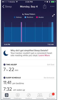

@Al_1 Can you please clarify something? Are you saying that for a night's sleep, you got a sleep score, but then Sleep Patterns, not Sleep Stages? Can you post a screenshot that shows this? Seeing what you see might help.
This Help article, What should I know about sleep stages? , shows an image near the end that is available any time a user gets Sleep Patterns instead of Sleep Stages. Does this show up on your screen?
Also, what model tracker are you using?

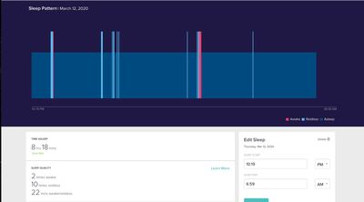

Thank you for your quick response.

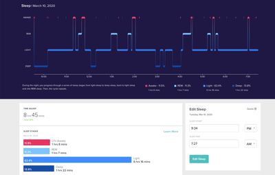

Yes, as of a few days ago I am only getting Sleep Patterns, not Sleep Stages (see below).
This is what I always used to get, up until a few days ago:

@Al_1 Thank you for your screenshots. They help a lot. The vast majority of Fitbit users sync with a smartphone on the Fitbit app and overlook the users that sync with a Mac using Fitbit Connect. You posted your question in the iOS phone app forum, so I hope you understand why we needed more information. (No harm, no foul.)
First, your web view doesn't give a sleep score. That is part of the phone app only. So that answers that. Second, your third screenshot is also from the phone app. That is why everything looks so different. There are times when all users will get sleep patterns when we expect sleep stages. Although you can't get the information from the web view, the most common reason is that your Charge 2 couldn't get a consistent heart rate trace. My husband wears a Blaze and gets sleep patterns at least once a week and he gets that explanation. Your Fitbit needs a consistent heart rate because it uses heart rate variability to determine sleep stages. Third, the Begin Sleep Now is also part of the phone app. Again, it doesn't apply to you.
Although it's not listed in the Help article I linked, some of us recommend restarting your Charge 2 once or twice and see if that helps. I also clean the back of my Versa 2 with a microfiber cloth that is damp, not wet, with alcohol. That will clean the LED emitters and the sensor. Also, try changing the position of your Charge 2 on your wrist. This is described in the Help article.
