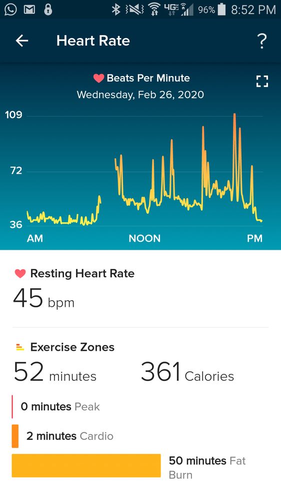

They don't have a resting heart rate limit line. My resting HR varies between 45 and 48 and I see it all the time. I don't pay for any features.
Yes indeed you are correct,  when I wear the Fitbit I can see it by looking at the Fitbit, but that’s where it stops.  It never reflects below 50 on the phone app, awake, asleep, etc.  it just stops recording on the app below 50.
that is what is so maddening.  The clear incontrovertible evidence on the device never gets reflected on the app.
Pateavenue, you misunderstand my post. It DOES show my heart rate below 50bpm, every morning. This image has the full day, so the high of my seep (45bpm) is not clearly marked, but it was 38 - 45 . overnight. I do NOT pay anything for the data in the app. No add ons.slepprate.png
These devices don't have a resting heart rate limit, per se, but they do have a lower limit in order to detect your heart rate.  Your Charge 2 has a lower limit of 40 when you are awake and 30 when you are asleep.  How do I track my heart rate with my Fitbit device?
