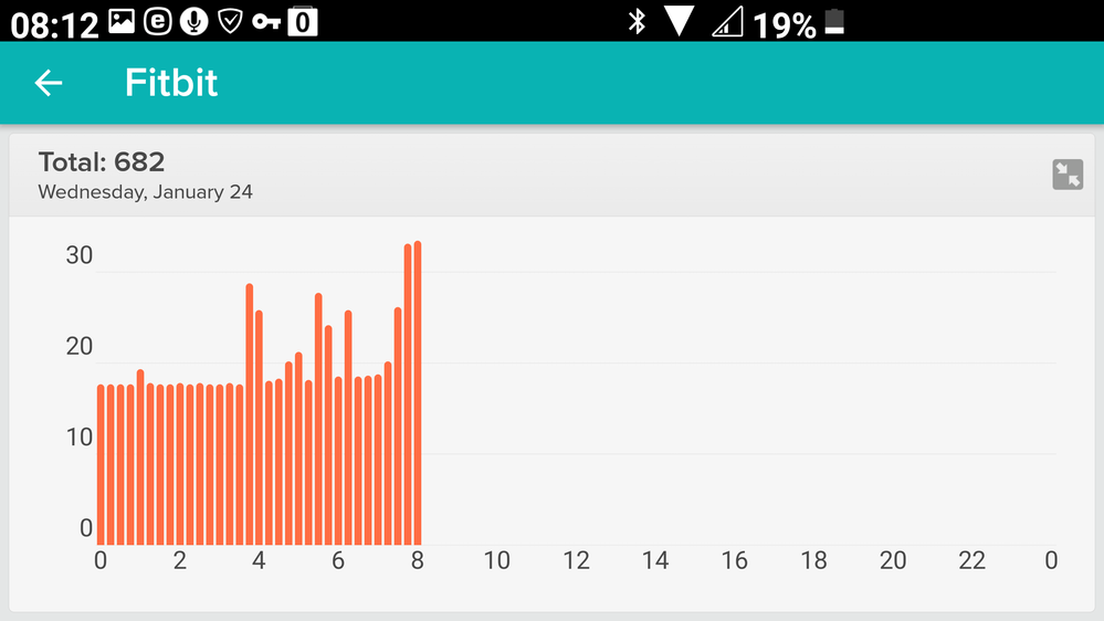

There were no more than 200 steps today. Steps not resetting at midnight. How could this be? There is now no known date. Restart is not used. The step number did not change. Help!!!. This way the device is completely useless !!!

I've done this already since 3 times and unfortunately did not use it. The situation is unchanged.
Why, when does this Fitbit do it? It's an ordinary weekday, not January 1. The latest firmware is on it (Firmware version: 22.22.55.2). Will they fix this bug?
Sorry, I now see: "This won't delete the steps but it will help your tracker reset to 0 the following midnight." I understand you!
