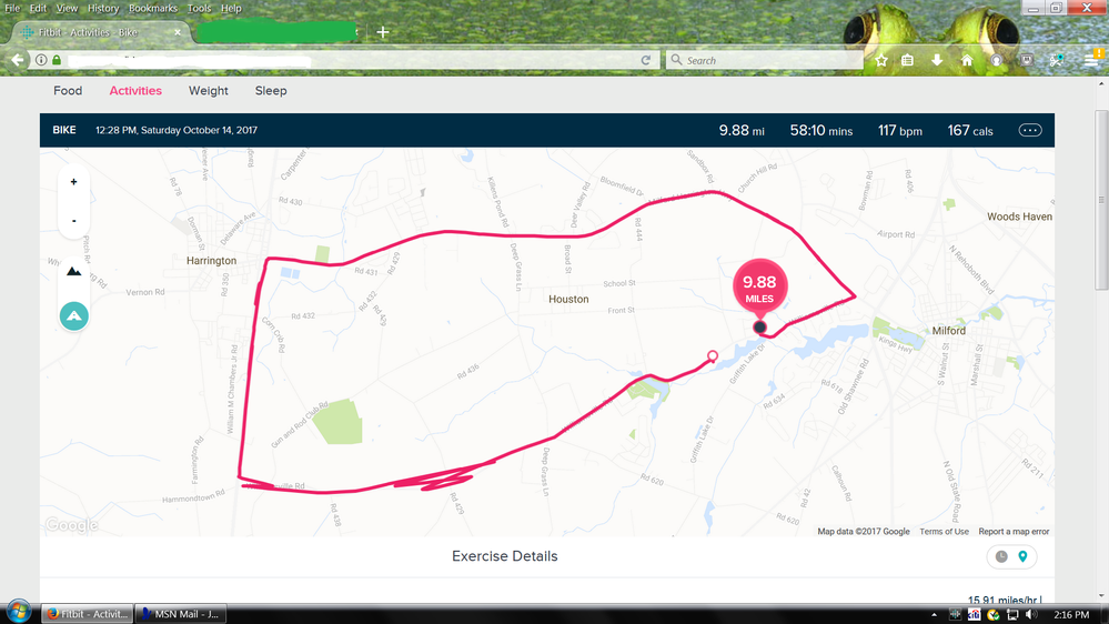

I contacted Fitbit about the gross inaccuracies with cycling distances. After the usual rehearsed response of the rep, I was instructed to restart the tracker, update, app, etc, etc,......A screenshot below indicates today's ride. Notice the wild zig-zags, which of course were NOT a part of the ride. Also the missing data and the incorrect data. This ride was actually 16.8 miles (I have ridden it many times and know the distance); the time is correct. The speed is grossly underestimated. actual avg speed was 17.5 MPH. With all the inaccurate data, my fitness scores are way off, heart rate is off......basically the tracker is providing false information all around...worthless!
