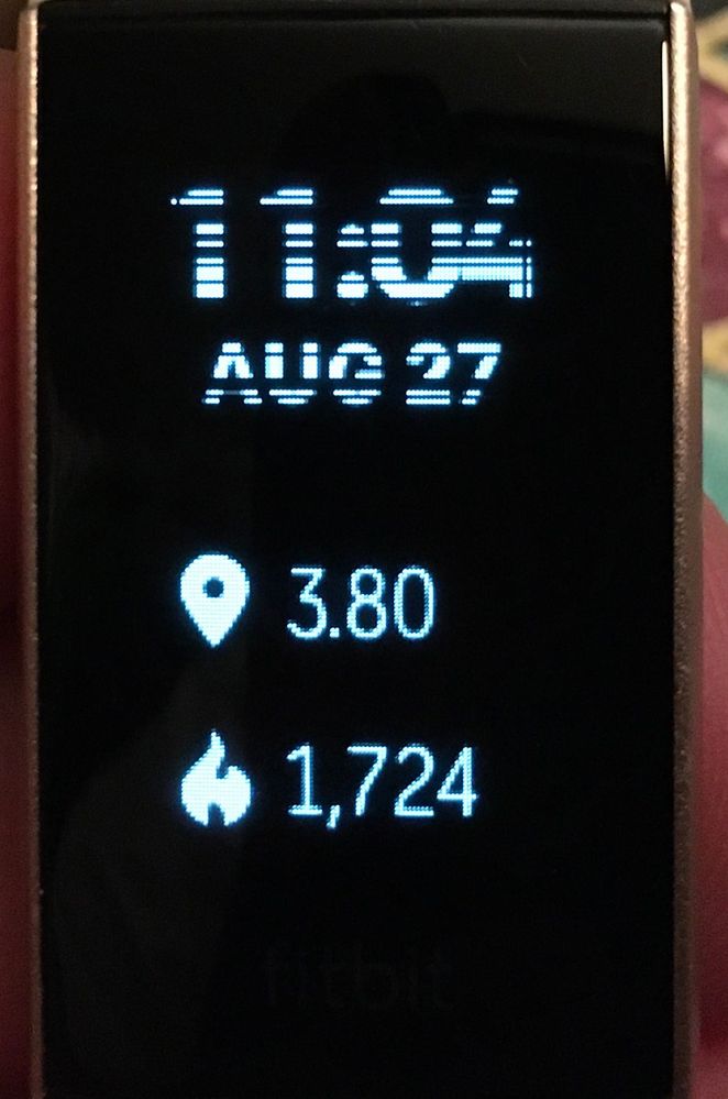

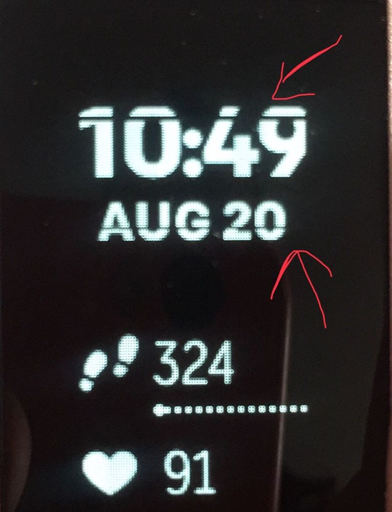

it did it to my charge 3, they want me to bu/y another charge 3 with a discount.
ONLY happened after the firmware update 8/20/2020
10-13-2020 12:31
10-13-2020 12:31
Same exact thing with mine. After the update I got the single line now a few days later it's become two. Also was offered discount to purchase no one. I call BS they messed it up with the update why should I have to buy a new one?!
