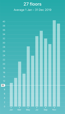

I am cross-posting this screenshot, so I might find this post being deleted. But for the people in this thread, I think another valid question is whether you also notice an increase over time.

@Adrienna27 wrote:@SunsetRunner I did notice the stair count issue started out mild-ish and seemed to worsen with time. It was counting over 75 floors per day by the time they replaced mine.
So, it does seem to get worse over time. Question is whether a replacement is going to solve it, or if it will just get me another few months of good readings until it gradually goes back to the same problem.
Yesterday, it said I did another 69 floors. 55 the day before. 51 before that.
When I look back, there are days with less, but overall, I am averaging between 30 and 60 floors per day. I might do 10-12 for real, sometimes less, but never what the device tells me.
While I am tech savvy, I did not really looked into getting the floor count out of the dashboard view. I found you can easily do that in the settings of the app. But that still doesn't answer the question whether the false readings influence the rest of the data. I suspect it does influence the readings and it gives wrong data. Reliability is out the window and the device seems to be a rather expensive watch.
Maybe I should contact support once again and also have this device exchanged, just like I did with the other one that had a black screen problem.

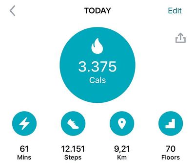

Today is another one with a crazy reading: 70 floors. Maybe I did 20. I’m going to check via dashboard and see if I can delete some again manually. Trying to figure out when exactly it’s making errors.
Pffff... What a joke.
Edit:
One hour later. Sat in a chair and read a book, went up 1 floor, brushed my teeth and got in bed.
That’s 225 steps, 170 meters, 5 floors, 151 cals difference. Sitting and reading, going upstairs, brushing teeth, getting in bed.

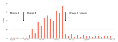

Quick update:
See the chart for comparison. This is August '18 until March '20. You can clearly see the upward trend after the switch from Charge 2 to Charge 3 (early '19). And again the immediate change after replacing the Charge 3 (early '20).

Another update: this seems to prove that the replacement keeps on doing a good job. Ever since the switch, the floor count is consistent and in line with the Charge 2 I had before.
It would be good to see this graph from others and compare results.
BTW: keep your Charge 3 away from water and do not swim with it. It is likely the cause of the misreadings.
