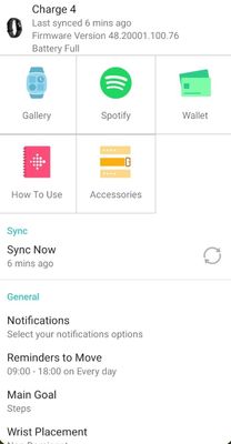

It's worth noting:
If you don't have / don't want a Premium subscription, you can't use Spotify on a free account.
If you are on a free account
  • Load Fitbit App on your device
  • Tap your picture (in the top left corner)
  • [Account] page, tap Charge 4
  • [Charge 4] page
If you tap that Spotify button, there is an [Uninstall] option
If you're on a free account, you want to uninstall so it stops prompting you to sign-in so Fitbit can connect to it.

You don't need to have. Spotify Account to disable it. Log into the Fitbit App on your mobile device (phone etc) and go into Charge 4 in your account settings.
If you tap on the Spotify logo there, you should have the option to completely stop your Fitbit from trying to link up with Spotify.
