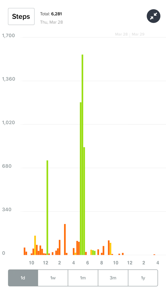

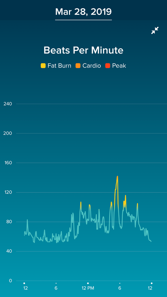

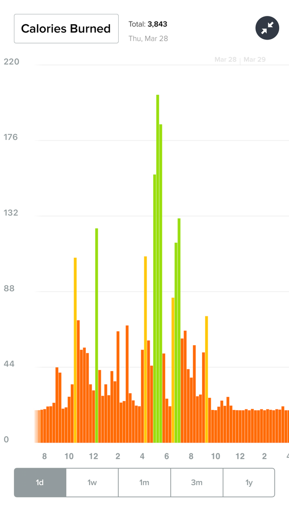

This is calories burned vs steps taken vs heart rate just looking at it I know it seems to ad up but there’s no way I burned almost 4000 calories in one day that I only walked 2.75 miles when I only burn about 3100 on days I walk 6 miles when I don’t have the hr on. Thank you for helping I think I will also contact customer support. I’m just trying really hard to become healthier right now and having something I can rely on to Be accurate is important
I think maybe the heart rate was registering too high because there no way I was anywhere near cardio on a simple walk
@Emileeflynn Looking at the chart you posted, the HR doesn't seem outrageously high... I am wondering about 2 things:

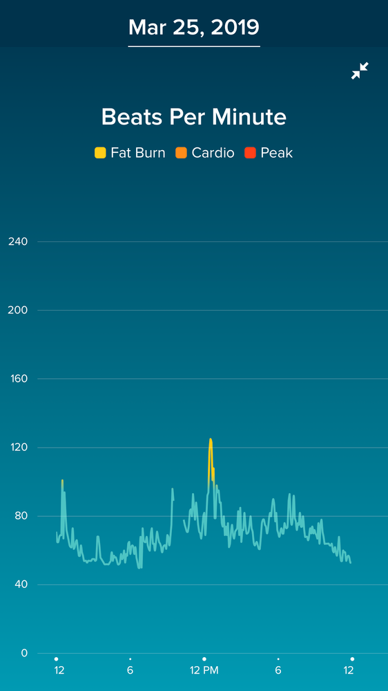

Yes I had a charge HR before this, is still be using that but I wore it in the shower by accident and it stopped syncing so I got this. This is a screen shot from a Day I was wearing the charge hr with almost the same level of activity and actually about 700 more steps. I’ve had my Fitbit account since September and all of my info is correct
Yes I had a charge hr right before this and this is a screenshot of a day that I was actually slightly more  active than the day I was wearing the inspire that i posted earlier over had my account set up since September  and all of my info is correct
@Emileeflynn this heart rate data does not look so much different. I am wondering if it's a problem on fitbit end. I mean with the calculations. But I have Inspire HR and never noticed that issue. On the other hand, I use it only for my indoor workouts, so I do not have daily recordings. If you really want to test it, you might need to create a second account to which you will link your inspire, then wear both trackers CHarge and Inspire and compare the data coming from both accounts. I did that myself before for Charge 2 and Versa. 😄 Also, Inspire is a brand new tracker. Fitbit is known for tweaking their algorithms within first few months when they get data from broader population.
