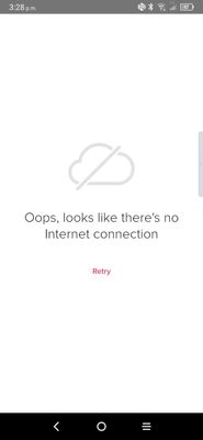

I have not been able to change the clock face on my Fitbit Inspire HR. I have read many forum posts and followed the instructions perfectly. Every time I click on clock faces inside the app I get a "No Internet" error (See attached image. This happens via Wifi and Mobile Data connection types.
I have rebooted the device multiple times both ways (connected to charger and using the reboot device heading under settings).
We have 4 Fitbit Inspires in my house, 3 HRs and 1 Inspire 2. None of the other devices have this issue and the clock faces can be changed without issue.
I have also unpaired the device, "forgotten" the Bluetooth device connection without luck. The device is about months old and I have never been able to change the clock face. I have however, once or twice,
been able to view the clock faces from inside the mobile app.

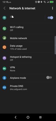

I have figured out my issue. It came to me like a bolt of lightning this morning. I use a private DNS server on my phone to block ads. The DNS server was the culprit. For some reason it would block the Clock Faces and the Apps tabs from opening.
I simply turned off the private DNS server and Viola: everything works now.
Selected my new clock face and turned the private DNS server back on.
Problem solved. Figured I'd put it out there on the slim chance that anyone else encounters this issue.
