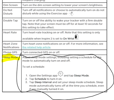

I don't have Inspire 2 in front of me.  Best I can do is reference Inspire 2 manual that you can look at too.
And note it is supposed to be a double tap to wake screen, and that can be turned off of Settings as shown above in "Double Tap" entry.
@2010lilypod wrote:
Hi.  Mine also is so dim in daylight I physically can't see the screen.   Where do I find the brightness settings you've mentioned please?
Look at my post above with screen cap from manual that shown Settings entry of "Dim Screen".  I guess that is only option.
