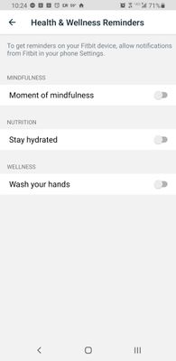

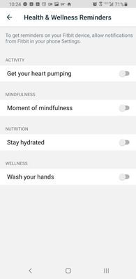

Oh, how weird!!  I went into that place in the app like 4x, and there were only three headings/options (mindfulness, nutrition, and wellness), and all three were disabled.  It just so happens your specifics on the "activity" heading (thanks!!) prompted me to go into that area a few more times to re-check, since I wasn't seeing that option, and thought I was losing my mind or something (lol).  Eventually, like some random fluke, that activity header (with "get your heart pumping" option under it) showed up, and was enabled...so I was finally able to disable it... And then the option DISAPPEARED again!!  🤦‍:male_sign:. If I keep going in, eventually the option randomly shows up here and there, but it's very random.  I hit the sync button and went in, and then the option showed up, so maybe that has something to do with it?  Regardless, there's clearly yet another bug with this functionality, and God knows how much time other Fitbit users have wasted with this crap.  😕
Now you DON'T see it...
...and NOW ya DO!

The Charge 4 users are right. there is no Activity. But if you exit the Health and Wellness Reminders, then click in the sync button for the watch and enter again , it appears Activity. Finally. It almost destroyed my nerves.
I went in and out 4 times before it came up. No rhyme or reason. So to recap, go to the device, scroll down, go to and out of the health and wellness settings at least four times, eventually the "get your heart pumping" option will appear and you can turn it off. Oh and BTW, I can't seem to bring it back up to turn on again if I wanted to. But I don't so. Fitbit please fix!
Yes. Enter and then exit and sync the watch and then enter and exit... As
many times as you need until it appears. I will attach the printscreen.

THIS! THIS! You have to go back and forth in this setting and SOMETIMES it magically appears. Other times it is not. I finally had one where it appeared and turned it off. I HOPE THIS WORKS. But this bug needs to be fixed. The setting isn't always there like in MaximillianC's screenshots show.
