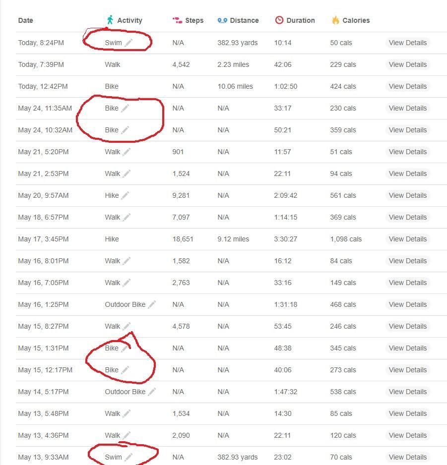

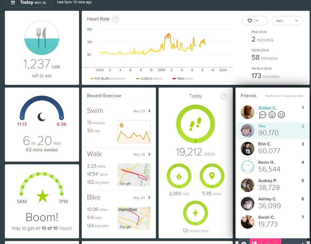

So I restarted my fitbit today and I gave the actual record my exercise instead of letting it auto track a try. Thought that is kind of cool but I still want it to auto track. At the end of the day i have pulled up to see how it all looks and after I did my evening walk I stopped in the laundry room and folded my clothes and the wonderful auto track makes that a swim. Here is two photos of my fitbit.com records. One shows all my activities for the past couple weeks. The red circles are things auto track recorded incorrectly and I edited after the fact. So the 4 "Bike" rides were shown just as a sport. The swim tonight was me folding laundry, the second one the last visible on the activity history was putting clothes away and it recorded it as a swim. I have also had 4 or 5 swims that did auto track and record what looked like relatively accurately when i did go swimming. It's so glitchy. Is this not what everyone experiences or is it just mine? I did restart it again tonight but honestly, I've done a restart each time I charge the battery and I charge it most days.

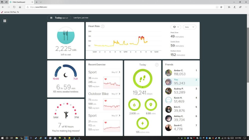

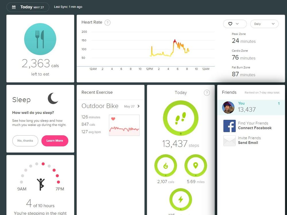

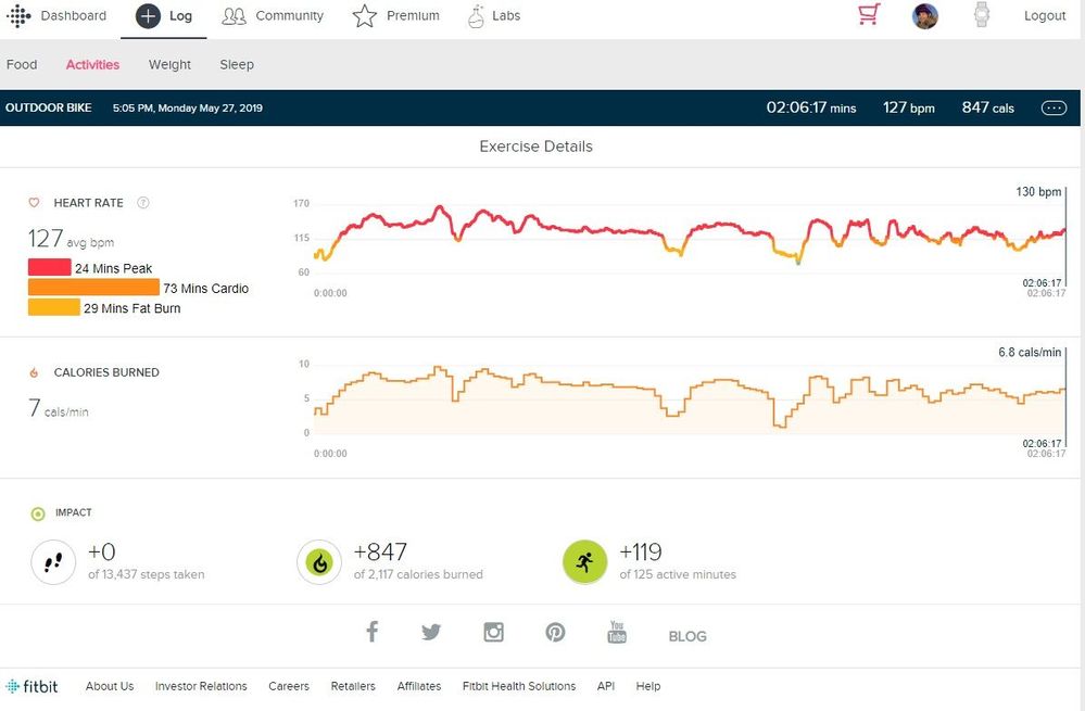

So am I the only one with this issue then? I must have a faulty Inspire HR then. I set up my alta HR on it's own account today syncing with my phone on a new account and the inspire is on my old account using my laptop to sync. So I thought I'd need a couple weeks to show the difference but today here is what happened. I went for a bike ride for a couple hours. Left my fitbits to auto track them. Fitbit Alta did it's usually, ignored I made a couple stops for water and photos and showed 1 outdoor bike ride for the full time. Here's the Alta account photo of dashboard and my outdoor bike ride, started at 5:05. Good they went for about the same time, alta show 5:05 for 2 hours and 6 minutes so finished about 7:11. Below on to what the Inspire recorded, which was three different exercises for my bike ride. See below photos.

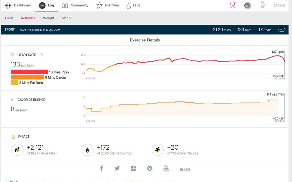

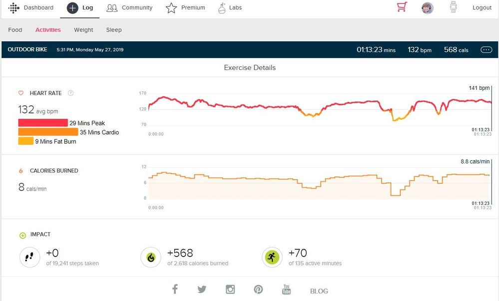

So above has been my experience with the Fitbit Alta HR for the past two years, nice records my rides even when I have small pauses for a drink or photo op or the rare time if I stop too long it goes two outdoor bike rides and almost never misses. So my Inspire has been erratic at recording rides and other sports on the auto track. I wore it on the arm I used to wear my alta HR on. Here is what it recorded today, I've owned it about 3 weeks now. You see it shows three different auto tracked activities, first a "sport", then "outdoor bike ride" then "sport"
First "sport" started at 5:06, close to the Alta HR but only 21:20, so ends at 5:27 Then Outdoorbike starts at 5:31, 4 minutes later, shown below.

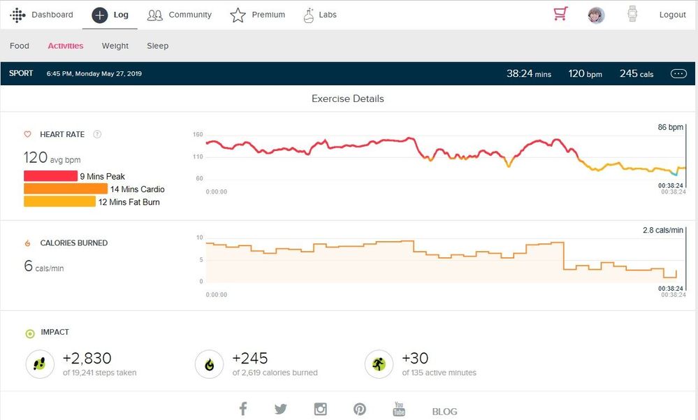

So my "outdoor bike ride" auto track at 5:31 pm went for 1 hour and 13 minutes ending at 6:45 pm and on to the third auto track showing on the Inspire, which shows again just as a "Sport"
So my "Sport" starts at 6:45 pm, same time the outdoor bike ride finished and goes for 38 minutes, so ends at 7:23 pm, 11 minutes after my bike ride ended as recorded by the alta and Strava, which I also had recording. Strava shows 2 hours and 6 minutes like the alta HR. Seems the inspire is messing up everywhere.

Oh one other note the inspire shows a total of 985 calories burned for the three sports making up my one outdoor bike ride as recorded on the Alta HR correctly and Strava.
Alta HR shows 847 calories burned for the total time. Maybe I burned the other 140 putting my bike away in it's locker when I got hom and that's what I did for the extra 11 minutes it recorded me doing a sport that the Alta and Strava did not record. The Alta HR was deadly accurate as usual. I start Strava when I start and finish when I am completed my bike ride and the Alta HR is pretty much dead on for auto tracking time start and duration with what I see on Strava for the past two years.
