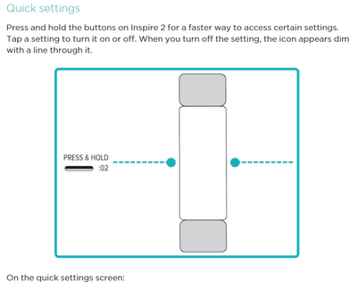

Check if you have Heart Rate turned if Settings or if in Clip Mode is Quick Settings, which turns off heart rate.

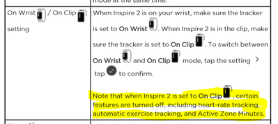

This is different issue from not syncing, but for clip mode:
From Inspire 2 manual (pdf)
