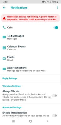

01-10-2020 17:57
01-10-2020 17:57
01-10-2020 17:57
This pops up regularly as well. Even if I restart my phone. Very frustrating.

You say that the phone gives you notifications while its screen is locked. I notice a screen shot that the Fitbit notification service is not running.
However I'm still looking forward to knowing what model phone we are having issues with.
