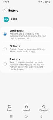

@JuanFitbit & @Julia_G ... Thanks for the input. Unfortunately that setting is already in place.
Bluetooth services are similarly unrestricted along with my music app that continues to work fine when the phone/app isn't open.

@Afob3 , Thank you for your reply and further information, as well as the screenshot attached.
Do you have other Bluetooth devices connected to your phone when recording an activity? (eg headphones, speakers, etc).
If so, this could explain the connection failure. Try using only the Inspire HR as Bluetooth device during the activity.
